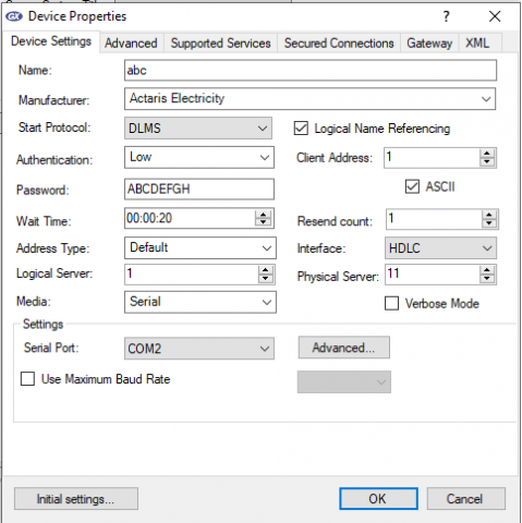

I'm Trying to communicate with Itron SL7000 Meter via DLMS director. Meter is connected to my computer via serial port. I can communicate with this meter by dedicated software ACE pilot but I cannot connect via Gurux DLMS editor. I attached gurux config.

Your meter is using different server address. ACE Pilot is using broadcast. Try to change Physical server address from 11 to 3FFF.
kuba245
5 years 11 months ago
It's a bit better , now I can
It's a bit better , now I can see that Rx diode flashed once, but still no response. now I get this in logs:
11:08:58 Send SNRM request.
TX: 7E A0 0A 00 02 FE FF 03 93 5E 92 7E
11:09:18 Data send failed. Try to resend 1/3 7E A0 23 03 00 02 28 E5 73 43 13 81 80 14 05 02 00 80 06 02 00 80 07 04 00 00 00 01 08 04 00 00 00 01 CE 6A 7E
11:09:38 Data send failed. Try to resend 2/3 7E A0 23 03 00 02 28 E5 73 43 13 81 80 14 05 02 00 80 06 02 00 80 07 04 00 00 00 01 08 04 00 00 00 01 CE 6A 7E 7E A0 23 03 00 02 28 E5 73 43 13 81 80 14 05 02 00 80 06 02 00 80 07 04 00 00 00 01 08 04 00 00 00 01 CE 6A 7E
11:09:58 Data send failed. Try to resend 3/3 7E A0 23 03 00 02 28 E5 73 43 13 81 80 14 05 02 00 80 06 02 00 80 07 04 00 00 00 01 08 04 00 00 00 01 CE 6A 7E 7E A0 23 03 00 02 28 E5 73 43 13 81 80 14 05 02 00 80 06 02 00 80 07 04 00 00 00 01 08 04 00 00 00 01 CE 6A 7E 7E A0 23 03 00 02 28 E5 73 43 13 81 80 14 05 02 00 80 06 02 00 80 07 04 00 00 00 01 08 04 00 00 00 01 CE 6A 7E
11:10:18 Failed to receive reply from the device in given time. 7E A0 23 03 00 02 28 E5 73 43 13 81 80 14 05 02 00 80 06 02 00 80 07 04 00 00 00 01 08 04 00 00 00 01 CE 6A 7E 7E A0 23 03 00 02 28 E5 73 43 13 81 80 14 05 02 00 80 06 02 00 80 07 04 00 00 00 01 08 04 00 00 00 01 CE 6A 7E 7E A0 23 03 00 02 28 E5 73 43 13 81 80 14 05 02 00 80 06 02 00 80 07 04 00 00 00 01 08 04 00 00 00 01 CE 6A 7E 7E A0 23 03 00 02 28 E5 73 43 13 81 80 14 05 02 00 80 06 02 00 80 07 04 00 00 00 01 08 04 00 00 00 01 CE 6A 7E
11:10:18
RX: 7E A0 23 03 00 02 28 E5 73 43 13 81 80 14 05 02 00 80 06 02 00 80 07 04 00 00 00 01 08 04 00 00 00 01 CE 6A 7E 7E A0 23 03 00 02 28 E5 73 43 13 81 80 14 05 02 00 80 06 02 00 80 07 04 00 00 00 01 08 04 00 00 00 01 CE 6A 7E 7E A0 23 03 00 02 28 E5 73 43 13 81 80 14 05 02 00 80 06 02 00 80 07 04 00 00 00 01 08 04 00 00 00 01 CE 6A 7E 7E A0 23 03 00 02 28 E5 73 43 13 81 80 14 05 02 00 80 06 02 00 80 07 04 00 00 00 01 08 04 00 00 00 01 CE 6A 7E
11:10:18 Send Disconnect request.
TX: 7E A0 0A 00 02 FE FF 03 53 52 54 7E
11:10:38 Data send failed. Try to resend 1/3 7E A0 0A 03 00 02 28 E5 73 F9 31 7E
11:10:58 Data send failed. Try to resend 2/3 7E A0 0A 03 00 02 28 E5 73 F9 31 7E
11:11:18 Data send failed. Try to resend 3/3 7E A0 0A 03 00 02 28 E5 73 F9 31 7E
11:11:38 Failed to receive reply from the device in given time. 7E A0 0A 03 00 02 28 E5 73 F9 31 7E
11:11:38
RX: 7E A0 0A 03 00 02 28 E5 73 F9 31 7E
Change the physical server address to A72.
kuba245
It's working with physical server address : A72. Problem Solved. Thank you.

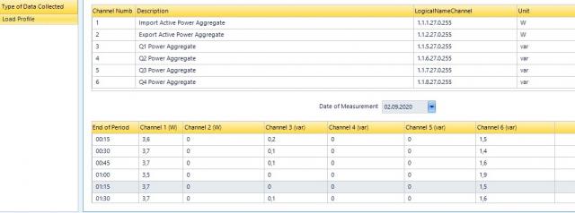

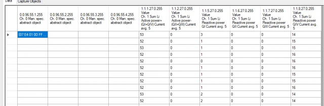

I'm trying to read profile data from the meter. I'm able to read ExtendedRegister 1.1.1.8.1.255, but I'm unable to read ProfileGeneric 0.0.99.1.2.255. Is this a known issue with this meter ? Is there an available workaround? it's not showing the 15 min period intervals and there is an unknown object.
kuba245
5 years 10 months ago
We are able to read the
We are able to read the profiles with the dedicated software ACE pilot. Here is the image attachment.
ITRON SL7000 is using own custom way to save the data. You need to ask documentation from the meter vendor that describes this data and how you can access it.
