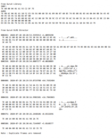

Thanks for the reply. I just want to perform the Disconnect and reconnect operation on Relay which is there in the meter.
Some how I'm able to send the SNRF and AARQ frames, But meter is not responding. I tried port sniffer for the GuruX DLMS director, the frames are different and i dont see SNRF or AARQ frames. Please let me know what can be done at my side.
Attachment : Frames

Please, paste text, not images. I can't compare the bytes from the images.

Here is the data as i couldn't upload text files.
From GuruX Library
SNRF:
7E A0 08 04 01 61 93 C2 DF 7E
AARQ
7E A0 6C 04 01 61 10 F2 E5 E6 E6 00 60 5D A1 09 06 07 60 85 74 05 08 01 03 A6 0A 04 08 5A 45 4E 4D 45 54 45 52 8A 02 07 80
8B 07 60 85 74 05 08 02 02 AC 12 80 10 70 38 9C CE 67 B3 59 AC 56 AB 55 2A 15 8A 45 22 BE 23 04 21 21 1F 30 00 00 00 00 0B
D3 DE D1 D6 74 52 D1 13 85 A2 D1 9E 8F A3 E9 5D D9 70 D3 A1 B2 2A 31 1B E4 98 23 7E
From GuruX DLMS Director
000202: 2020-07-28 20:28:53.5595913 +1.0099290
7E A0 21 00 02 04 01 61 93 10 E6 81 80 12 05 01 ~ !....a“.恀...
FA 06 01 FA 07 04 00 00 00 01 08 04 00 00 00 01 ú..ú............
3E A9 7E
7E A0 6E 00 02 04 01 61 10 71 8E E6 E6 00 60 5D A1 09 06 07 60 85 74 05 08 01 03 A6 0A 04 08 5A
45 4E 6D 65 74 65 72 8A 02 07 80 8B 07 60 85 74
05 08 02 02 AC 12 80 10 6F 51 07 4A 5C 29 27 58
49 6D 40 4A 45 3D 1C 01 BE 23 04 21 21 1F 30 00
00 02 58 D2 57 74 CB 4B 60 2E 5F 77 D1 3A 33 A0
0B 0E 90 E7 44 2C 0B CB AB 94 88 8D ED 6D 15 7E
000350: 2020-07-28 20:28:54.0807277 +0.0020889
7E A0 41 00 02 04 01 61 32 16 F6 E6 E6 00 CB 30 ~ A....a2.öææ.Ë0
30 00 00 02 5B DB CF CC 95 B9 F8 99 08 9A 5F 8B 0...[ÛÏÌ•¹ø™.š_‹
8E 40 69 99 A9 FC 01 2B A2 D4 A2 78 D7 46 2A 7C Ž@i™©ü.+¢Ô¢x×F*|
18 11 D8 F9 4D C6 FD 6D 14 8F E4 1B 25 BA 27 A1 ..ØùMÆým.ä.%º'¡
9F E3 7E Ÿã~
000400: 2020-07-28 20:29:59.0719708 +64.7692484
7E A0 31 00 02 04 01 61 54 6A E1 E6 E6 00 CB 20
30 00 00 02 5C C8 BE D7 FC 1A C2 18 51 D3 1C B7
1F 65 A1 09 0E 64 B7 06 77 93 D3 B6 DA 4C 74 6E
7F 7E
000438: 2020-07-28 20:30:16.9901501 +16.7043065
7E A0 31 00 02 04 01 61 76 7A E3 E6 E6 00 CB 20 ~ 1....avzãææ.Ë
30 00 00 02 5D FF 20 0A 5C 09 B4 81 A3 EF 51 FC 0...]ÿ .\.´£ïQü
5F 00 D6 AA 0D DC 6E F5 DD E3 02 D4 54 0A 73 C2 _.Öª.ÜnõÝã.ÔT.sÂ
47 C3 7E GÃ~
000476: 2020-07-28 20:30:26.2448106 +8.0322696
7E A0 14 00 02 04 01 61 98 2A 7E
000580: 2020-07-28 20:30:46.7144907 +5.0168577
7E A0 0A 00 02 04 01 61 53 1D 35 7E
Note : Duplicate frames are removed

I believe that you are reading Invocation Counter in GXDLMSDirector. You need to read it before you make a ciphered connection with ANSI C.
