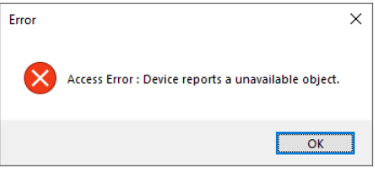

Currently, I am testing the Indian Standard (IS15959-2) meter.
For the first time, Connecting meter and download all supported objects from the meter using utility association. Now I am doing write operation directly (Not read) for following obis code of an object type "Data".
- 1.0.0.8.4.255 (Profile Capture Period)
- 1.0.0.8.0.255 (Demand Integration Period)
- 0.0.94.96.19.255 (Metering Mode)
- 0.0.94.96.20.255 (Payment Mode)
So, While writing value on this obis code got error as shown in attachment.
If I read these obis code first and then perform write operations then it is working properly.
Can you please check for above-defined scenario and provide an update.
