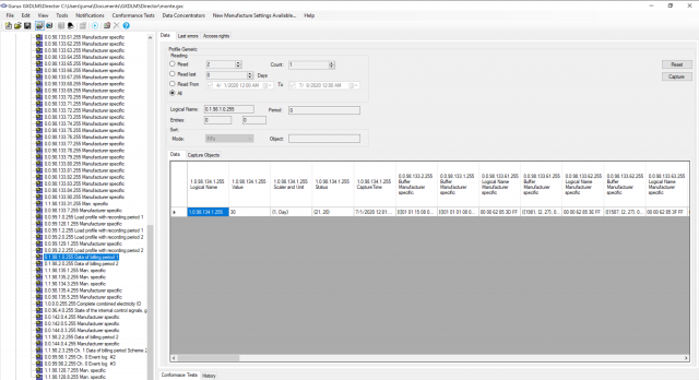

I am new to using Gurux and I am trying to read the Billing Profile of an SL7000 meter and I encounter the following problem:
I have only been able to read the last set, I have tried 2 different meters that have different firmware and I always get the last set.
On the other hand, I downloaded the historical data from both meters with ACE PILOT and I get all the SETs stored, but with Director or with the Python client example only the last one.
I would like to know what I am doing wrong or what is the limitation and would appreciate the help.
Attached screenshots.

Hi Juan,
Hi Juan,
I'm sorry, but we are little bit busy to help our clients at the moment, so I can't check this using your meter at the moment.

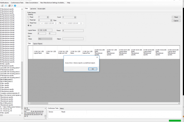

I check the data. There is only one row where are 66 columns. What if you try to select "All" instead of read by entry? Are you still receiving only one row?
juma
6 years 3 months ago
In reply to Hi Juan, by Kurumi
When I use readall I get an error message:
Access Error: Device rerports a undefined object.
Is this due to an access restriction?
Or could it be a problem with the data obtained?
Attached screenshot of the screen.
Thank you

Meter is not supporting this funtionality for this object and it's returning en error. You need to read using entry. Are you sure that you are reading the same Logical Name (0.1.98.1.0.255) with ACE Pilot?
ACE pilot is reading profile generic with logical name 0.1.98.1.0.105 and not 0.1.98.1.0.255.
Can you find 0.1.98.1.0.105 from the GXDLMSDirector?
