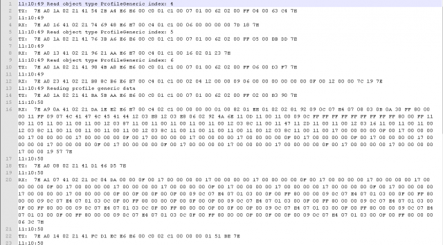

Device supports multiple profiles, out of which, on reading one of the profile data, error message popup "The number of columns does not match", other profile's data are read successfully without any error.
Specific profiles data structure is as below (Profile on which popup message appears)
01 02
Array with 2 elements
02 81 92
Structure with 146 members
Other profiles data structure is as below (Read successfully)
01 02
02 35
Structure with 53 members
1. My query is, does tool supports structure with more than 128 members? What is the way to send more than 128 members, if BER (Basic Encoding Rules) is not followed?
2. Does BER (Basic Encoding Rules) applies to structure or not? Is it only applies to arrays and octet strings only?
For reference I have pasted the log data (Its complete log data, after reading attribute 2, tool gives error, it doesn't even go for attribute 3)

6 years 2 months ago
Please, don't paste images. It's hard to read bytes from them. There is no limit for amount of columns. You haven't added capture objects of profile generic so I can't tell the reason.
There should be 146 columns. Count amount of the columns. I believe it's something else than 146.
