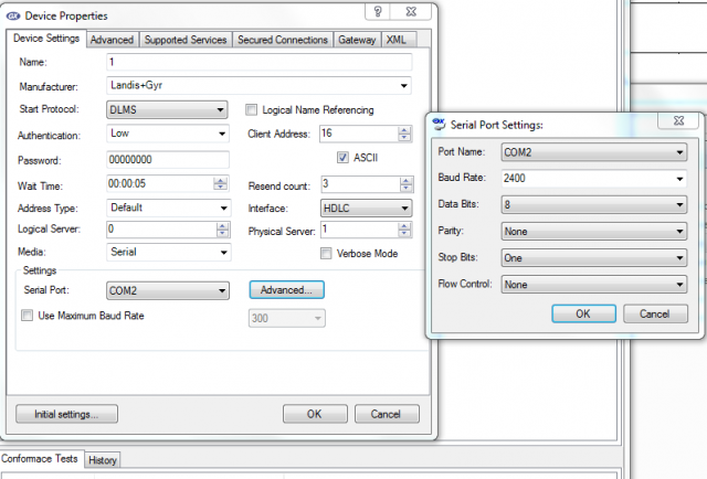

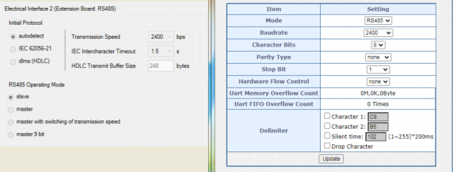

I upload screens about converter and meter settings
6 years 4 months ago
Change client address to 0x13. You can also change start protocol to IEC.
It should work also with DLMS.

Now i again test in GXDLMSDirector. Converter in "Virtual Com Mode" (Screen: https://prnt.sc/t62xjy) with ip 192.168.5.5.9761
I try using next parameterts:
1) https://prnt.sc/t62vhy - Nothing happens
2) https://prnt.sc/t62z08 - i'am add Serial Number meter, some nothing happens.
3) https://prnt.sc/t630kv - now, i'm create Vitual COM port in my PC, and reconfigure GXDLMSDirector, some to nothing happens, get this error - https://prnt.sc/t631xt
4) https://prnt.sc/t632cw - now i change "Adress Type" to Default, and nothing happens.
5) I try using ur commanline command and get error : https://prnt.sc/t638wc
When i click connect in GXDLMSDirector i seen in my VCOM software (soft to create virtual com ports on pc) https://prnt.sc/t632zk line with COM2 becomes RED and status port "Opened". This indicates that the port has opened and the program is trying to connect to the counter.
Following the logic of things, I generally do not need a program for emulating COM ports, because the Planet converter can do this already .
Change SN to sn. Give parameters like this:
main.py -S COM2:2400:8None1 -r sn -c 19
If it fails add -i parameter.
In GXLMDSDirector check "Use serial port through ethernet".

This is tested with RS-485 and it works without problems. Can you share what kind of converter you are using (modem and manufacturer)?
Pelathaon
Hello, Planet ICS-10X
Planet ICS-10X
Pelathaon
