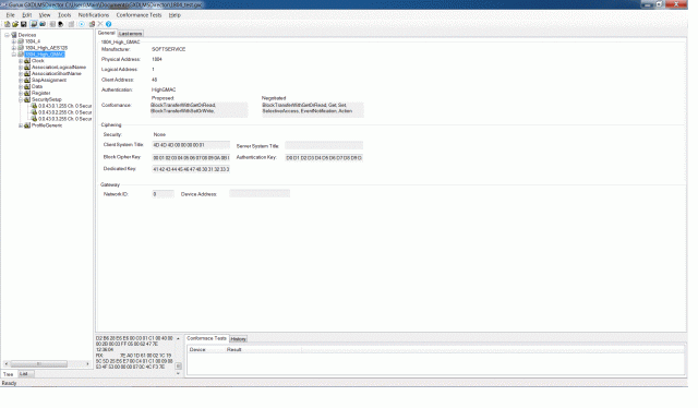

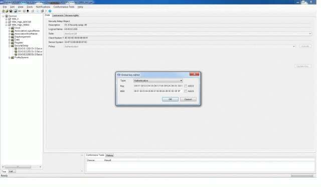

Hi.
Hi.
1. The COM port monitor is turned on to show that at the physical level, the meter responds to the Action request with success, which the Client does not perceive.
2. In the screenshots, the configuration of the keys GXdir_2 and the key update window GXdir_1.
3. After processing ActionReq (01 01 02 02 16 02 09 18 C4 98 42 9F F0 B8 E6 98 35 2B 17 AF FA C7 CA 6C 70 8D 61 06 2E 82 B6 D4), result iv = 0xA6, 0xA6, 0xA6, 0xA6, 0xA6, 0xA6, 0xA6, 0xA6 and new AK = D0 D1 D2 D3 D4 D5 D6 D7 D8 D9 DA DB DC DD DE DF.
Where is the error?

First, try to increase timeout to 10 seconds. Meter is sending an action response but after the first re-try. There is also invalid frame after-action response.
