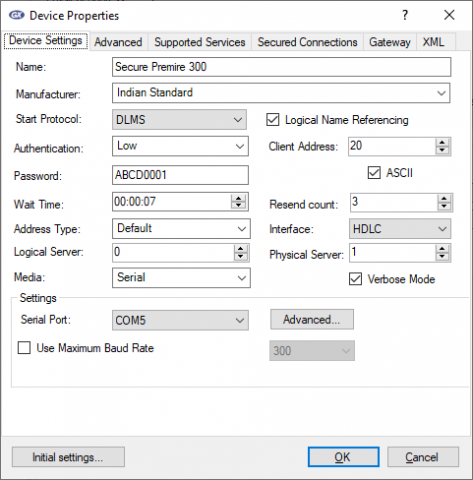

I am getting ServiceError ReadException. Service Unsupported while trying to read anything from Secure Premier 300 meter. Log is given below.
GXDLMSDirector 8.2.2006.1702

I am using Indian Standard, Low authentication and client address Hex 20. Able to successfully connect but not able to read anything.
This was working perfectly fine few days back.
Please help.
6 years 2 months ago
Select Advanced tab and check "Get" service. That should fix the problem.
