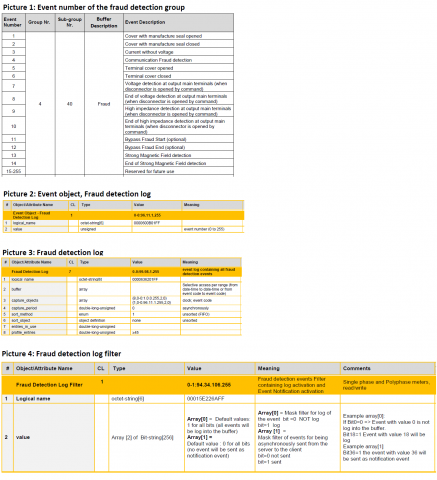

We have several groups of events divided on subgroups. Each group or subgroup has its own event log.
Every event has a unique code to identify the action which has triggered it. Every event is assigned to one event log and it is only stored there. This assignment is fixed and can’t be changed dynamically.
Any events could make the server builds an EVENT-NOTIFICATION-Request APDU and send it out in order to inform the client of the value of it. The events that are affected by this Service are configurable through Objects Events Log Filters.
We will clarify the above statements by an example:
Fraud detection (group number: 4, sub-group number: 40, event number: 1 -> 14) check the picture 1:
Contains all events related to the detection of fraud attempts, e.g. removal of terminal cover, removal of meter cover, strong DC field detection, access with wrong password.
Structure: Timestamp – Event Code
Minimum size: 45 entries
