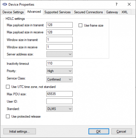

However, I want to use them for DLMS meters to make frame size lesser. Or you can say
whether those parameters are applicable for DLMS frames that we need to send and receive?

You can set those values selecting Advanced-tab in GXDLMSDirector and modify HDLC settings.
OR:
GXDLMSClient cl = new GXDLMSClient();
cl.Limits.MaxInfoTX = cl.Limits.MaxInfoRX= 256;

As you suggested we already set HDLC settings using Advanced-tab in GXDLMSDirector. However, when we read IEC HDLC settings we got different values.
Please check the attached screen shots.

6 years 6 months ago
HDLC setup shows default values. In the Advanced page, you set proposed values that the client proposes when making the connection. Note! All the meters don't support this.
Try to change max payload from 128 to 250 in Advanced page.

I tried to set required length and yes as per your suggestion it was set. However, when I tried to read Profile Generic, I received data more than set values.
Set Max length in TX/RX = 200
Received data length = 208
Regards.
TX/RX size is the size of payload, not size of the frame.

Mikko, Can you please help me to set the PDU size with which frame size will not be exceeded more than 200 bytes?
Regards.
Change max payload from 200 to 192 in Advanced page.

KhushbuBadheka
Thanks Mikko.
Thanks Mikko.
It Worked.
