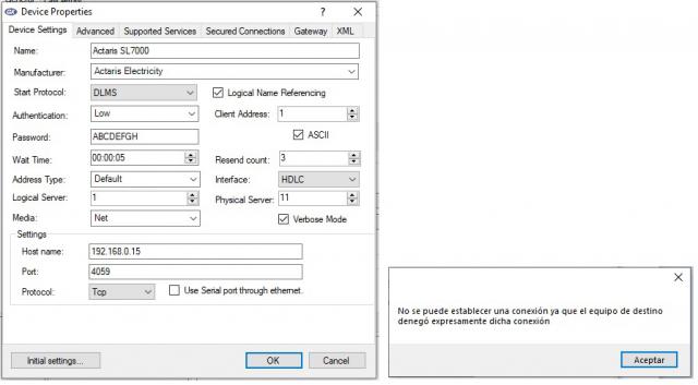

Hello, Itron SL7000 (Actaris
Hello, Itron SL7000 (Actaris SL7000 type SL761), after GXDLMSDirector initial configuraion and connect --> showed pop-up: " No se puede establecer una conexion ya que el equipo de destino denego expresamente dicha conexion ". Please help me to connect and read this device with GXDLMSDirector, where I can to read information for achievement it...
6 years 5 months ago
Your error is coming from the operating system. I believe that your TCP/IP port number is invalid and TCP/IP connection is not established.
