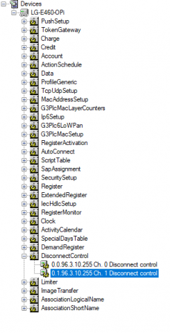

I am having some problems with a Landis and Gyr Prepayment/Prepaid meter (Sample Unit) E460, regarding DisconnectControl.
I can read the values from the meter, but for some reason, I cannot write a command back to it,
the image indicates the presence of the DisconnectControls.
My question is, is this a access control issue that I do not have write access to the DisconnectControl object to "reconnect/disconnect"?

We don't have L+G E460 here so I can't verify this. What authentication level you are using?
Can you post the trace from the disconnect event? Please, send only a disconnect event trace, not the whole trace file.

I have low authentication, client and server addresses 1, and a password provided to me.
Trace in Hex (Reconnection):
13:04:54 Method object 0.0.96.3.10.255, interface DisconnectControl
TX: 7E A0 14 03 03 D0 7F 87 E6 E6 00 05 01 04 5D 98 01 0F 00 EF F3 7E
13:04:54
RX: 7E A0 10 03 03 3C F1 D8 E6 E7 00 0C 01 01 03 DB B3 7E
Disconnect Trace:
13:06:18 Method object 0.0.96.3.10.255, interface DisconnectControl
TX: 7E A0 14 03 03 F2 6F 85 E6 E6 00 05 01 04 5D 90 01 0F 00 37 16 7E
13:06:18
RX: 7E A0 10 03 03 5E E5 98 E6 E7 00 0C 01 01 03 DB B3 7E

We are testing a new version where this is fixed for Short Name Referencing. We'll release it today.
6 years 7 months ago
There is a new version from GXDLMSDirector where this is fixed.
