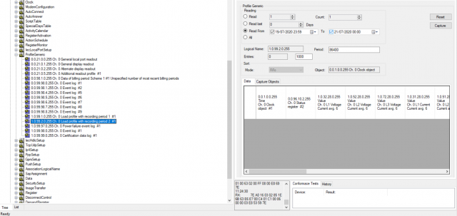

I changed captured data 1.0.99.2.0.255 (added). I could not read data after that. I changed it back and I still read nothing... Here is the trace:

6 years 3 months ago
Buffer is empty. There is no data. The reason is start and end times.
Start time: 21.7.2020 0.59.00
End time: 21.7.2020 1.00.00
Change them. Try to read last day.

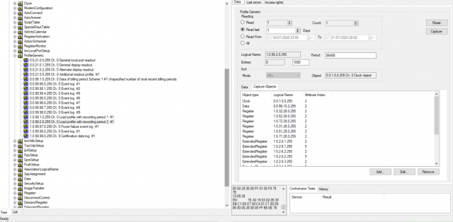

MrSupe
I have it right (check
I have it right (check attachment)...I extended it for one day more:
Buffer is still empty. Some meters expect that seconds and minutes are zero. What if you read the latest day? Is that working? Try to read values where start time is 1.00.00 and end time is 11.0.0. Is that working?
I'm not sure because the pic is bad, but if I see correctly the amount of entries is zero.
Press "Capture" button and read again.
Buffer is usually clear when you modify capture objects.
It might be that meter can't handle if you change capture objects. Can you reset the meter? You will lose all you collected data if you do this.
You can do Global Meter Reset if you find Script Table 0.0.10.0.0.255 and read scripts and execute script #1. NOTE! All meter settings are reset to factory defaults and usually all data is lost.

Mikko I got it...
Mikko I got it...
These ProfileGeneric data (if I change capture registers) will react correctly after period has elapsed (in my case 86400s). I dont know if it is MT880 feature only or it is general feature. But immediately after midnight it start to read correctly (not empty buffer).
P.
You are right. This profile generic is saving data once/day. Period is 24 hours (86400s).
I did try to check it from the pic, but it's compressed and I can't read it.
