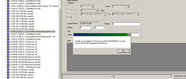

Hi Mikko
we are getting following exception on DLMSDirector
please find attachment

It worked without problems. What is your GXDLMSDirector version? I'm using 8.2.2002.501.
Is Gurux.DLMS.AMI on the Linux or Windows?

Same problem.
Same problem.
Director version 8.2.2002.1202
AMI on Centos with MariaDB ( Director on Windows station ) and AMI on Windows with MSSQL ( Director on "localhost" )
When I want to change Hostname = error is like at Rahul's picture.
When I want to add any OBIS to scheduler = error message is "Object reference not set to an instance of an object"
Scheduler was disappeared for every device. There is Schedulers only for every Devices ( Templates, SystemErrors, Readers, Schedulers )
For any Device there is no Scheduler ( Gneral, Last errors )

Am using AMI on Linux .
6 years 3 months ago
This is now fixed. Get the latest version.
