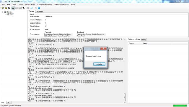

Hello.
I'm trying to read Landis+Gyr Meter (ZMD405CT44.2407) as i did times before with older versions of gurux DLMS. Now I encounter error when i'm getting the association view.
I get the following error: Unacceptable Frame 3 times in a row and then it shows connected but no object list gets created as it was in previous versions.
If I hit refresh button the error is more specficic as: "GetObjects Failed: Unacceptable Frame"
I got the same behaviour with 3 different meters from the same brand and the exact same model.
These are the last lines of the trace.

Can you try to read a meter again and send the whole frame to me by email? We can check this.

Hi Federico,
Hi Federico,
This is fixed. Get the latest version from GXDLMSDirector.

Hi Mikko.
Hi Mikko.
Got the latest version and everything is working.
Problem is fixed.
