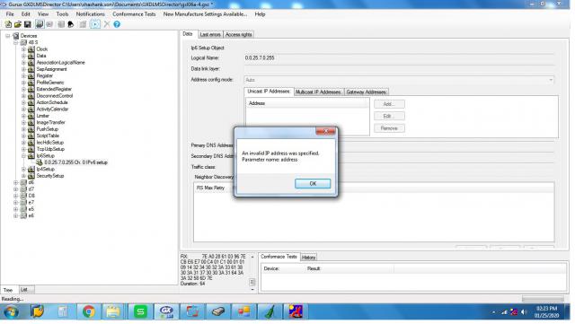

I have got an invalid IPV6 address error in the Gurux while reading it. Suggest what is the reason behind it.
See log
GXDLMSDirector 8.1.2001.1601
Log created 02:23:16 PM
14:23:19 Initializing serial connection.
02:23:20 PM Send SNRM request.
7E A0 20 03 61 93 1B 9F 81 80 14 05 02 02 00 06 02 02 00 07 04 00 00 00 01 08 04 00 00 00 01 6F EF 7E
02:23:20 PM
7E A0 20 61 03 73 05 9E 81 80 14 05 02 02 00 06 02 02 00 07 04 00 00 00 01 08 04 00 00 00 01 6F EF 7E
14:23:20 Parsing UA reply succeeded.
02:23:20 PM Send AARQ request.
7E A0 4C 03 61 10 58 27 E6 E6 00 60 3E A1 09 06 07 60 85 74 05 08 01 01 8A 02 07 80 8B 07 60 85 74 05 08 02 02 AC 12 80 10 07 1C 3E 0B 00 20 1E 38 0C 53 23 14 12 41 22 0D BE 10 04 0E 01 00 00 00 06 5F 1F 04 00 00 1E 1D FF FF EE E1 7E
02:23:20 PM
7E A0 58 61 03 30 07 51 E6 E7 00 61 4A A1 09 06 07 60 85 74 05 08 01 01 A2 03 02 01 00 A3 05 A1 03 02 01 0E 88 02 07 80 89 07 60 85 74 05 08 02 02 AA 12 80 10 47 65 6E 75 73 08 06 07 6D C0 07 14 01 25 23 20 BE 10 04 0E 08 00 06 5F 1F 04 00 00 18 1D 02 00 00 07 EA DA 7E
14:23:20 Parsing AARE reply succeeded.
02:23:20 PM Authenticating.
7E A0 2B 03 61 32 8D EB E6 E6 00 C3 01 C1 00 0F 00 00 28 00 00 FF 01 01 09 10 E6 95 1F A3 E5 53 2A 0F 26 85 4C 6A 06 47 EA D3 84 24 7E
02:23:21 PM
7E A0 24 61 03 52 62 DC E6 E7 00 C7 01 C1 00 01 00 09 10 5E 56 57 F3 E6 F0 62 68 A0 0E F0 C9 09 38 CC 55 0D F9 7E
02:23:22 PM Read object type Ip6Setup index: 1
7E A0 19 03 61 54 39 98 E6 E6 00 C0 01 C1 00 30 00 00 19 07 00 FF 01 00 5B 14 7E
02:23:23 PM
7E A0 18 61 03 74 90 43 E6 E7 00 C4 01 C1 00 09 06 00 00 19 07 00 FF FA B2 7E
02:23:23 PM Read object type Ip6Setup index: 4
7E A0 19 03 61 76 29 9A E6 E6 00 C0 01 C1 00 30 00 00 19 07 00 FF 04 00 E3 6A 7E
02:23:23 PM
7E A0 28 61 03 96 7E CB E6 E7 00 C4 01 C1 00 01 01 09 14 32 34 30 32 3A 33 61 38 30 3A 31 37 30 30 3A 31 64 3A 3A 32 58 6D 7E
System.ArgumentException: An invalid IP address was specified.
Parameter name: address
at System.Net.IPAddress..ctor(Byte[] address)
at Gurux.DLMS.Objects.GXDLMSIp6Setup.Gurux.DLMS.Objects.IGXDLMSBase.SetValue(GXDLMSSettings settings, ValueEventArgs e)
at Gurux.DLMS.GXDLMSClient.UpdateValue(GXDLMSObject target, Int32 attributeIndex, Object value, List`1 columns)
at Gurux.DLMS.GXDLMSClient.UpdateValue(GXDLMSObject target, Int32 attributeIndex, Object value)
at GXDLMSDirector.GXDLMSCommunicator.Read(Object sender, GXDLMSObject obj, Boolean forceRead)
at GXDLMSDirector.MainForm.Read(Object sender, GXAsyncWork work, Object[] parameters)

Your meter returns IP v6 address in textual format ("2402:3a80:1700:1d::2"). Other meters are returning this as 128 bits byte array.
Can you ask your meter manufacturer to fix this?
