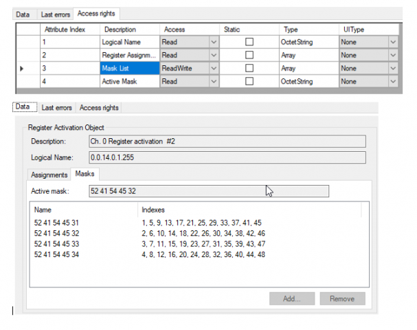

I am unable to edit the mask list for the register activation class even when the mask list has read-write access. This works fine with other tool provided by the manufacturer. Below are some screenshots of GXDLMSDirector.
BR
Pramod

This is now fixed and tests are started. This is fixed to next release.
6 years 9 months ago
This is now fixed. Get the latest version.
