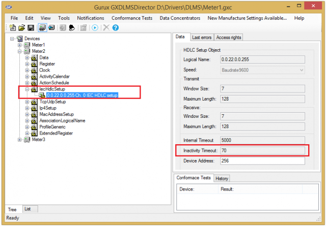

Yes, I had read the inactivity timeout from the IEC HDLC setup object and wait (70 seconds as given in the attached screen-shot) for the same but unable to connect the meter. For this case (Whenever kill from task manager), I am to restarting the meter and then able to connect the meter.
I am sharing the logs and screen-shot of IEC HDLC setup object parameters.
Kindly suggest for this case what should I do.

After you crash the GXDLMSDirector you need to wait at least 70 seconds before the new connection. After that, you must make a connection to the meter as before. This is in DLMS tests. You need to ask meter manufacturer to fix this if your meter don't pass this. There is nothing that you can do for this. This is a meter issue.
