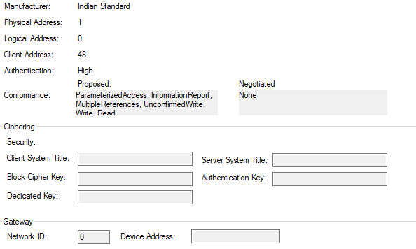

I am new to DLMS meter. I have taken gurux.dlms.server.example2.java as meter and DLMS Director as client.
I am trying to connect meter in secure mode with settings as shown in attached screenshot. But I am getting below error.

Director has interface as
Director has interface as WRAPPER and meter is also having interface as WRAPPER. Then what is the issue ?

I tested this by my self. I started gurux.dlms.server.example2 project. Then I selected "Indian Standard" to meter manufacturer and changed Interface from HDLC to WRAPPER. Then I set correct TCP/IP address and port number to 4063. Meter reply as expected.
Check that you have not made any changes to the source code. Nobody else has this problem.

6 years 9 months ago
I checked it again. Issue is occurring when security is set to "AuthenticaionEncryption". I have set SystemTile
BlockCipherKey
Authentication Key
as well.
Can you pls share your Security settings if it is working fine.
