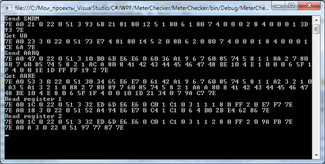

Then, i tried use this commands in my C# programm, but i got this log(picture):
What's problem? Did I miss something?
Maybe some delays?

I found mistake. frame type
I found mistake. frame type of GET request is different in every frame.
6 years 10 months ago
Frame ID is increased for each time you send data or meter reply. It's correct.
Please, don't send images. It's hard check the bytes.
DemoniKsataNa
That means, i can only send 7
That means, i can only send 7 get requests?
I mean: 0x32, 0x54, 0x76, 0x98, 0xBA, 0xDC, 0xFE. And then i have to send snrm and AARQ requests again? Weird technology...
No, frame sequence number starts again from zero. Please, use open source libraries. You are spending time. If HDLC framing is causing now problems, wait until data is coming in fragments.
