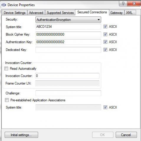

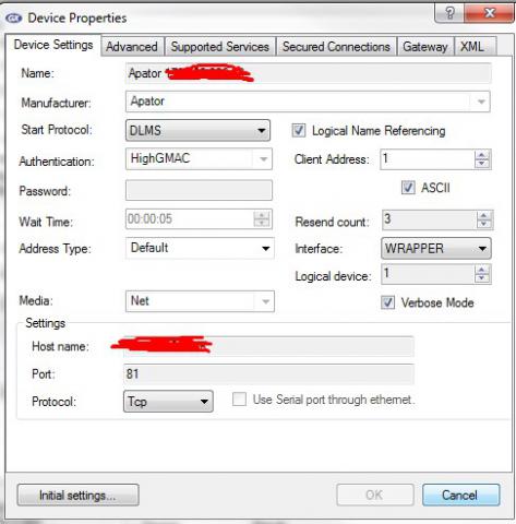

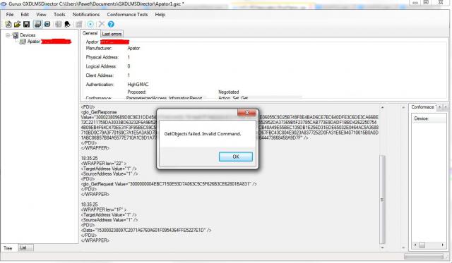

I attached also the results for the GXDLMSDirector tests. After connection I couldn't read the Association view.
Thank you!
Paweł
paulws85
6 years 10 months ago
Next image from the
Next image from the GXDLMSDirector
paulws85
Next image from
Next image from GXDLMSDirector
Meter reply for AARQ correctly, but when you are sending Client to server challenge it fails to reply.
Is this implemented for the meter?

CallingAuthentication is a random challenge and it might vary. You can set "Challenge" in "Secured connections" tab if you want to use same challenge every time.
I believe that one of your settings is invalid and for this reason meter read fails.
