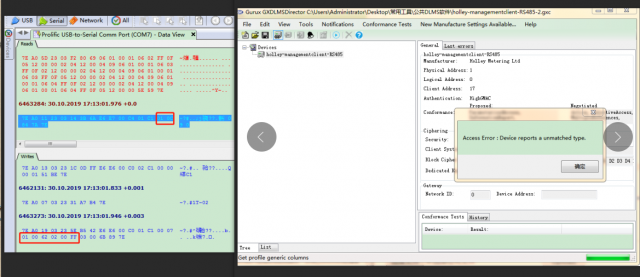

my err describe:
when I click read object button,
first, read classid = 15, att=2;
second, read OBIS;
in the second step, it will read the object which i don't support. such as (0007*0100620200FF*03) .
and I check meter send to DLMSDirector, don't have this obis.
so my question is:
1. how did this DLMSDirector work, have some technical usermanual decument?
2. in this situation, meter reply 'unmatched type', I think it's OK, but DLMSDirector stopped and report err.

Please, don't post images. It's hard to read. Post plain traces.
You should check this:
https://www.gurux.fi/GXDLMSDirectorHelp
Is this profile generic in association view or have you added it by yourself?
If profile generic object is not supported meter should return "Unknown object" error and not "'unmatched type'".
