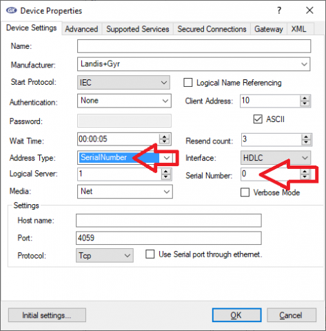

Change Address type from "Default" to "SerialNumber". Then set the serial number.
See pic below.

Correct Mikko, that's what I
Correct Mikko, that's what I did at the very beginning:
1. Established successful connection using Address Type: Default and logical device: 1.
2. Disconnected.
3. Changed address type from "Default" to "SerialNumber".
4. "Logical device" label changes automatically to "Serial number".
5. Input my serial number into "Serial Number" field.
Then I get "System.TimeoutException: Failed to receive reply from the device in given time." in gurux director logs.
