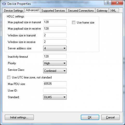

Set 1his:
1. Authentication to Low.
2. Client address to 1.
3. Set password
4. Set Logical Server to 1.
5. Set Physical Server to 64.
6. Set "Server Address size" to 4. This is on Advanced tab.

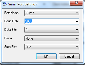

And baud-rates are the same? GXDLMSDirector uses 9600, but if I remember right some Actaris meters might use 4800.
DemoniKsataNa
6 years 9 months ago
I changed baudrate to 4800.
I changed baudrate to 4800. no results. Meter even doesn't see that program try to connect with it. It's just do nothing. There is old version of the program? Maybe it works...

Frames are now the same. Only thing is that Max info and window size is missing because they are defaults. Can you select Advanced-tab and set "Window size in transmit" to 2. It's now 1. It causes that proposed values are sent.
DemoniKsataNa
It didn't worked.

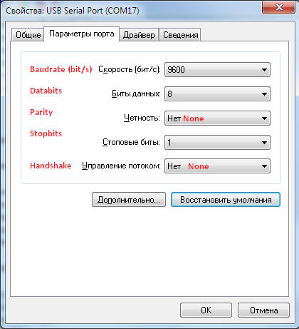

My Converter is Mercury221.
My Converter is Mercury221. RS-485 half-duplex(i guess you call it just duplex). But sl7000 has rs-485 full duplex in Rj45 port. But i connected Tx- with Tx+(1st and 8th contacts of rj45)and Rx- with Rx+(4th and 5th contacts of rj45) and got half-duplex.
DemoniKsataNa
It doesn't work anyway.
Amis and NForce works(yesterday the didn't work correctly, because of bad wire, but today they work great. But your program doesn't work, anyway.
It's log of Nforce program:(It's in russian, but i guess your more interested about HEX data)

Bytes what we are sending are the same. The problem is in serial port connection and its settings. Can you see what handshake is selected?
DemoniKsataNa
None in settings my serial
None in settings my serial port in device manager of windows. There no such option in your program(handshake i mean).
Those are default settings, and the application can change them.
Get the latest version from GXDLMSDirector. Handshake is added to the settings.
Select "Advanced" in device settings.
Try to change "Flow Control" from None to "RequestToSend". Try to make a new connection.
DemoniKsataNa
There is no "Flow control"
There is no "Flow control" option in here.
Select "Advanced..." from "Device Settings" -tab.
DemoniKsataNa
There no this option too...
Can you select "Help" | "About" and check your version number. It should be 8.2.1910.3102.
DemoniKsataNa
6 years 8 months ago
Yes. Handshake is None.
