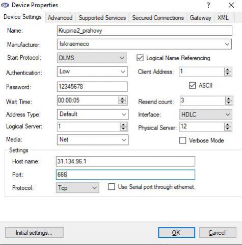

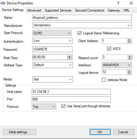

Communication with GXDLMSDirector setting works with this Properties:
1. Media: NET, Protocol:TCP, Interface: Wrapper, Use serial port through ethernet: Checked
2. Media: NET, Protocol:TCP, Interface: HDLC, Use serial port through ethernet: Checked
3. Media: NET, Protocol:TCP, Interface: HDLC, Use serial port through ethernet: Not Checked
Does not work:
4. Media: NET, Protocol:TCP, Interface: Wrapper, Use serial port through ethernet: Not Checked
How can I set communication parameters in java for first three cases? I am able to set only 4th case :-(

1. -h IP_ADDRESS, -p PORT_NUM -w
2,3. -h IP_ADDRESS, -p PORT_NUM
I don't know if you need to set the client address. Run java app without parameters and it shows the help for you.

WRAPPER is used with TCP/IP or UDP connections. It's not used with serial port connections.
If you are using TCP/IP to the serial port converter you need to end frames using HDLC framing.

Try to add -w parameter. Iskra is using WRAPPER.

TX: 14:51:36.524 00 01 00 01 00 12 00 38 60 36 A1 09 06 07 60 85 74 05 08 01 01 8A 02 07 80 8B 07 60 85 74 05 08 02 01 AC 0A 80 08 31 32 33 34 35 36 37 38 BE 10 04 0E 01 00 00 00 06 5F 1F 04 00 00 1E 1D FF FF
But, if I check "Use serial port through ethernet" it works on GXDLMSDirector. Without it it does not work. This is exactly what I dont know set in Java.
Please try it maybe you will succeed and something wrong on my side.

Hi Peter,
Hi Peter,
You can also connect directly with TCP/IP to some Iskraemeco models and then wrapper is used.
Can you post the first two lines from GXDLMSDirector trace? The client address is usually 0x64 and the physical server address is 0x11 for Iskraemeco.

Hello Mikko,
Hello Mikko,
so after some work:
1a. request from GXDLMSDirector: 7E A0 08 02 25 03 93 E7 A2 7E
1b. java request: 7E A0 07 25 03 93 6E C4 7E
After changing Address size from defautl to 2 (and a manipulating with server addres) I also got 7E A0 08 02 25 03 93 E7 A2 7E with same response. That is important step...
But after that java starts to generate lot of requests, here are some of them from the begining...
