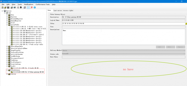

the Token gateway have a methods 1.enter(data)
how to exectue it, It seems that I didn't find it on the software.

You are right. It's missing. We are testing it at the moment and it's on the next release.
