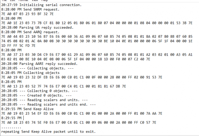

I've an electric 3 phase meter DTSD545, Holley.
With RS485 and DLMSDirector, there is successful connection between my ardiuno and DTSD545 on GXDLMSDirector.
However, I can not call object list from DTSD545. How you please advise me how to call a object list /Association View/

Please, don't attach images, use plain text. It's easier to check the bytes.
From the log, it seems that it's not implemented for the meter. The association view is empty.
You must add objects by hand.
Select "Add object..." from "Edit" menu.
