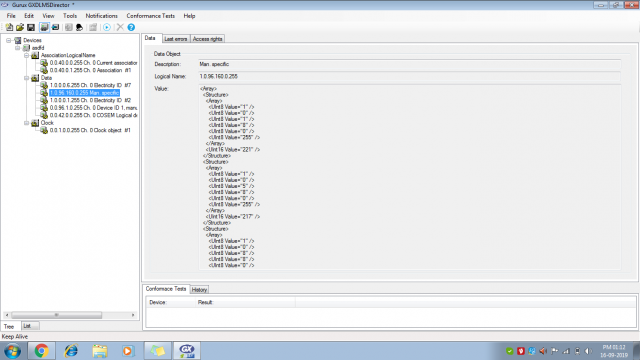

As per your advice we are moving forward with the DLMSDirector. We were able to get the v3.5 of the DLMSDirector working.
We were able to connect to the meter as well and read data.
But still don't know where the data as required here is:
7 years ago
This is manufacturer-specific data. You need to ask from the manufacturer what data is shown here.

Hi Ambimat,
Hi Ambimat,
I believe that you need to change the authentication level. I believe that you are using authentication level None at the moment and the meter is returning this info.
When you increase the authentication level, you can see more COSEM objects.
