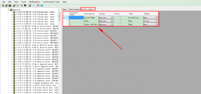

  3. If GXDLMSDirector.exe Can Analysis Class_id = 15, Version = 3?
if GXDLMSDirector.exe can analysis class_id = 15, version = 3?
By holley-cgd , 16 September, 2019
meter use class_id = 15, version = 3, and has passed CTT3.0 report.
GXDLMSDirector.exe can read all object. But "access rights" can't analysis.
can you tell me GXDLMSDirector.exe can analysis class_id = 15, version = 3 or not?
7 years ago
GXDLMSDirector can show only read-access and write-access bits. When I was checking this I realize that if you have multiple bits set it don't work correctly.
I'll add this to the worklist.
holley-cgd
7 years ago
thank you. than I know
