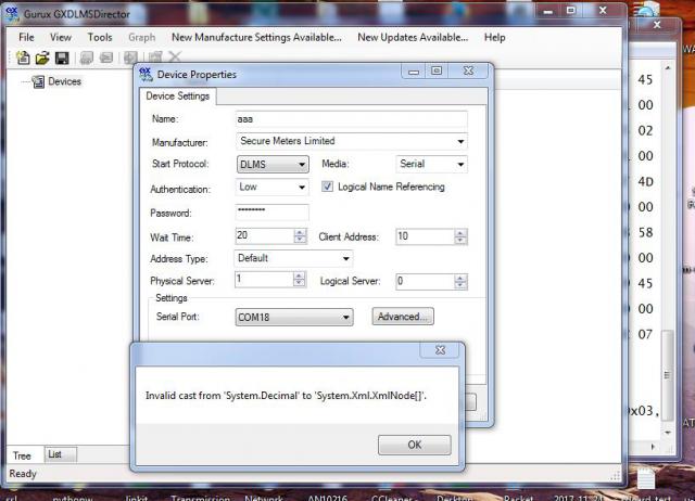

We are trying to get our Secure Meters Premier 300 connected to the PC.
Can you please check internally and let me know how to do it?
We have tried ourselves and we are not able to get the device connected due to the error attached with this message.

This is tested with a different kind of environments and we can't get your error message. What version you are using from GXDLMSDirector?

Tried V3.5 and it is working
Tried V3.5 and it is working fine for us.
V4.6 isn't.

I just notest from your image that you are using some very old version. I don't know where did you get it, but download the latest version from gurux web page.
