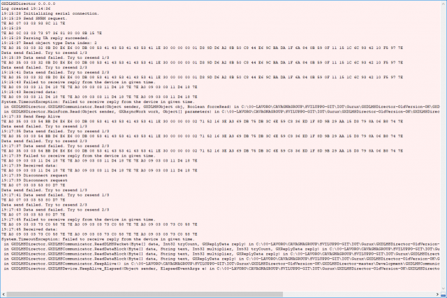

Can you send your image as a log? I'll check this, but I need a log.

Hello. Thanks for you support
Hello. Thanks for you support.
This is the text log: see below.
I cannot understand if there are configuration troubles or incompatibility between our meter firmware and the last Gurux version (I hope it's impossible ...).
Really thankyou for the support!!!

simtheo
7 years 1 month ago
I didn't change the source
I didn't change the source code: I only debugged the Gurux source code project and the DLMXDirector source code project for better understand the protocol.
Thanks.
MatteoS
7 years 1 month ago
Hi Matteo,
Hi Matteo,
I believe that "General Protection" is not selected. Can you select device settings and select "Supported services" tab. "General Protection" should be checked.
