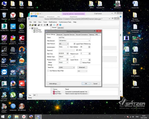

  3. Unable To Connect To Iskra Me371 Via Optical Port
unable to connect to iskra me371 via optical port
By vslab , 19 July, 2019
GXDLMSDirector 8.1.1906.1301
Log created 16:21:17
16:21:19 Initializing serial connection.
16:21:20 IEC Sending:/?!<CR><LF>
16:21:21 HDLC received: /ISK5\2ME371-2105<CR><LF>
16:21:21 BaudRate is : 9600
16:21:21 Moving to mode E.
06 32 35 32 0D 0A
16:21:25 Send SNRM request.
7E A0 08 02 23 C9 93 E4 43 7E
16:21:25
7E A0 1F C9 02 23 73 B4 96 81 80 12 05 01 7E 06 01 7E 07 04 00 00 00 01 08 04 00 00 00 01 5F 75 7E
16:21:25 Parsing UA reply succeeded.
16:21:25 Send AARQ request.
7E A0 2C 02 23 C9 10 F6 B8 E6 E6 00 60 1D A1 09 06 07 60 85 74 05 08 01 01 BE 10 04 0E 01 00 00 00 06 5F 1F 04 00 00 1E 1D FF FF C5 E4 7E
16:21:25
7E A0 39 C9 02 23 30 22 BD E6 E7 00 61 2A A1 09 06 07 60 85 74 05 08 01 01 A2 03 02 01 01 A3 05 A1 03 02 01 0C BE 11 04 0F 08 01 00 06 5F 1F 04 00 00 1C 1D 04 00 00 07 D5 26 7E
16:21:25 Disconnect request
16:21:25
Gurux.DLMS.GXDLMSException: Connection is permanently rejected. Authentication mechanism name is required.
help
vslab
7 years 2 months ago

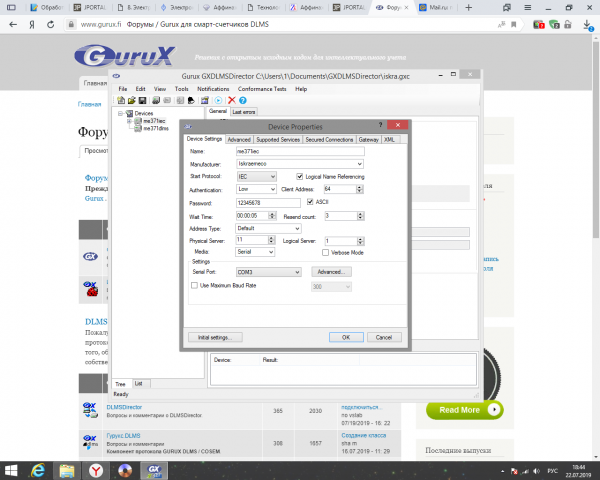

connected to these settings.
connected to these settings. read-only.
Error message describes it: Connection is permanently rejected. Authentication mechanism name is required.
You can connect only using low or High-Level authentication. The connection is not allowed without authentication.
