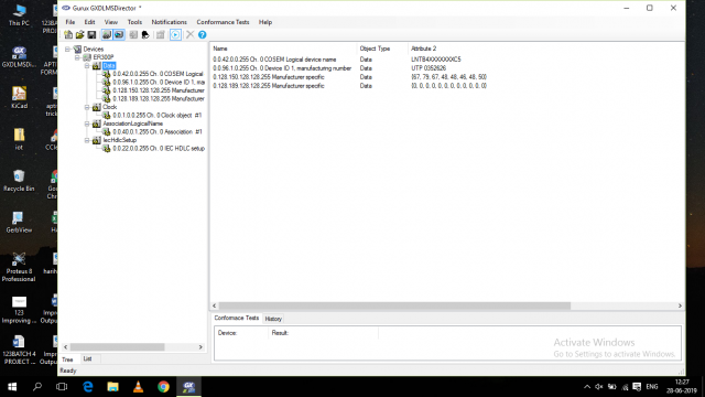

I have get some datas from the GXDLMSDirector. I don't know it's worked or not, If it's working right please tell me which is KWh,KVArh. I have attached the screen shot below. And one more thing I used new ER300P meter, So no load is connected to yet.

Try to change the authentication level from None to low or High. Your meter doesn't return those values when authentication is not used.
