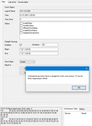

Hello Gurux.
While trying to read clock object (0.0.1.0.0.255) from my Italian meter i recieve an arror (see screenshot).
This translates to english as:
"Offset must be in bounds of +/-14 hours.
Parameter name: offset"
It started after setting meter's Clock using button "Current TIme" in GXDLMSDirector.
It probably set some wrong value to meter?
Reading via Java library gives me NullPointerException
16:35:58 Read object type Clock index: 2
TX: 7E A0 2C 03 03 10 59 E8 E6 E6 00 C8 1E 30 80 00 07 A3 FB B6 80 C9 65 E2 E1 B5 B4 B5 29 9C 84 6F 6E 58 12 4F 11 87 A4 2C 5B 9C BB E4 43 7E
16:35:58
RX: 7E A0 31 03 03 30 75 81 E6 E7 00 CC 23 30 00 00 0B 29 9A 06 A6 A7 1F 55 8C F4 6A 3C E1 01 03 E3 F2 F7 B8 F2 50 20 39 3A D5 8D 19 4C AE 01 CE C9 05 72 7E

UPDATE:
UPDATE:
Same error also happens when reading GSM Diagnostic (0.0.25.6.0.255) Object!
bleg
7 years 5 months ago
UPDATE:
UPDATE:
Problem with clock solved by Setting timezone back to +180 (from -60) using Java Client
But problem with GSM Diagnostic still exists
Your messages are encrypted and I can't check the reason. Can you select "View" | "Trace" and "PDU". Post xml from trace window and I'll check the reason.
