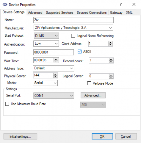

Hi, Darcarper
Hi, Darcarper
We finally managed to connect to a ZIV counter. The trick was to use the following addresses:
-.Client: 1
-.Server: 144
Hope this is helpful and you manage to get it to work.
7 years 3 months ago
In reply to Hi, Darcarper by NamBanLad
Thank you from this info. What authentication level you are using with that client address?

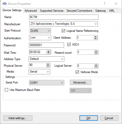

NamBanLad
We managed to do so with the
We managed to do so with the following configuration:
Server Address: 144
Client address: 2
Authentication Level: Low
Password: 00000001 (although the standard should be 00000007)

NamBanLad
Hello, Darcarper
Hello, Darcarper
The client address is 2. Also, although the server address is 144 -decimal- you should enter it in hexadecimal -that is, 90.
Here is a capture of the configuration we used to connect.

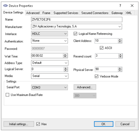

Borlang93
5 years 1 month ago
Hi, I would like re-open this
Hi, I would like re-open this topic, since I started to work with ZIV5CTM smartmeter recently. I also have problems, in particular with authentication stage. Without authenticacion (none), I can read some OBIS like characteristics of the smartmeter or clock. However I cannot obtain energy data, Im using serial communication USBTTL - RS232, should I add an optical probe too? I tried also to introduce manually OBIS but non-success.
5 years 1 month ago
In reply to Hi, I would like re-open this by Borlang93
Hi Borlang,
Hi Borlang,
You need to change the authentication level from none to Low.
