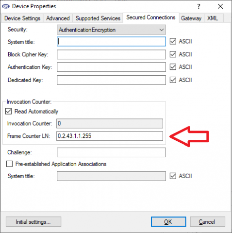

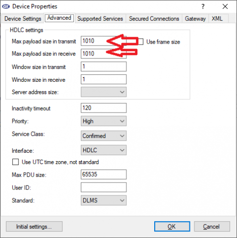

Kamstrup OMNIPOWER is a little bit special case. You need to set MaxInfoRX and MaxInfoTX to 1010.
See pic below. If you want to use encrypted connections you need to select "Supported Services" tab and check "General Protection".

In reply to Kamstrup OMNIPOWER - THREE-PHASE METER by Kurumi
Thanks. It worked :-)

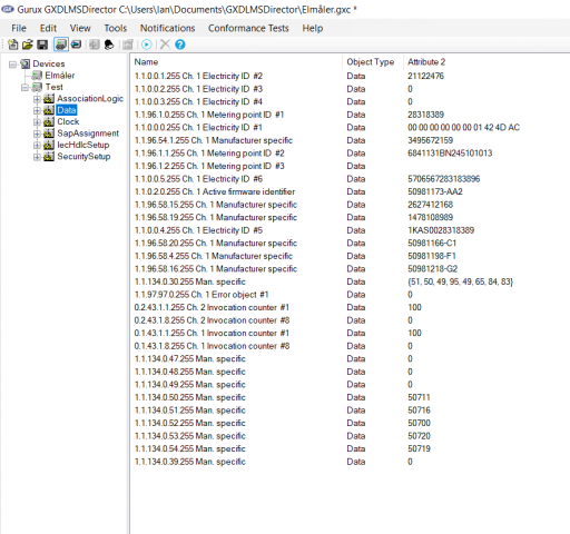

Kamstrup is using custom OBIS codes and not standard ones. You need to find correct OBIS codes from the meter manual or ask them from the meter vendor.

You can find Kamstrups OBIS codes listed in this document:
https://norgesnett.no/wp-content/uploads/2019/01/Datablad-HAN-modul.pdf

If you are not receiving data from the meter check your system title, block cipher key, and authentication key. Try to set frame counter (see pic). You can try to set it manually, or ask GXDLMSDirector to read it every time you make a connection. Set LN to or 0.2.43.1.1.255.
It's sad that Kamstrup is using custom OBIS codes. It causes that comparing data between the different meters is impossible.

I found that the system title is the _client_ system title and that you can specify server system title further down on the config page. I had mistaken the first system title for the server system title.
After that I managed to get a encrypted connect (no password). C=x14 S=x10 but when reading the objects collected unencrypted all the values were cleared as if the OBIS codes could no longer be accessed.

The Server system title I took from the SecuritySetup returned in public mode, but I'm not sure if it is correct.
I'm using same Radius key for both authentication and encryption.
asbjoern

I just got an email from Radius that said that the encryption key we got is not valid for DLMS/COSEM, only for Kamstrups proprietary and NDA protected KMP protocol.
They do not have the capability to hand out the encryption keys for DLMS/COSEM but they have asked Kamstrup to find a solution.
So I guess we will see what happens.

What does OBIS codes look like?
Actual voltage phase L1 U-L1 32.7.0
Actual voltage phase L2 U-L2 52.7.0
Actual voltage phase L3 U-L3 72.7.0
https://byggebolig.no/imageoriginals/a92e2b86218347e3bd529f440661cd65.p…?
