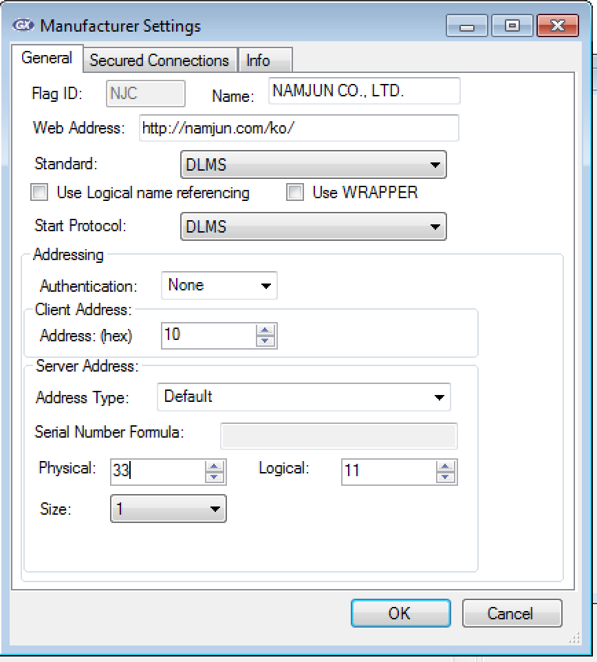

Then, they created a manufacturer through 'Tools-Manufacters-New' from DLMSDirector.
Flag ID : NJC
Web Address : http://namjun.com/ko/
Standard : DLMS
Start protocal : DLMS
But I don't know what 'Client Address' means. Also Server Address - Phycial Address, Logical Address too.
I really don't know.
Thank you.
7 years 12 months ago
Device settings
You need to ask client and server address from the manufacturer, but you can use with these:
client address: 10
Server address: 1
Select also "Use logical name referencing".
