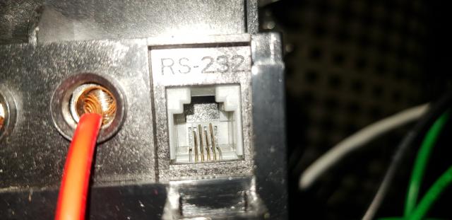

I am in search of reading L&T energy meter real time data through its RS232 port, the RS 232 signal is on RJ11 4 pin female connector, please help me to read the same and display the parameters like voltage, current, kwh etc in PC. The meter is L&T's EM101+ which is DLMS compliant. The pics of communication port and meter is attaching herewith.
Anoop
anoopeld
6 years 11 months ago
In reply to Hai Sir, by anoopeld
Pic of Communication port
In reply to Pic of Communication port by anoopeld
Please, if you have a new question start a new topic. You can use GXDLMSDirector to read your meter.

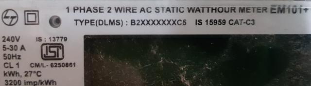

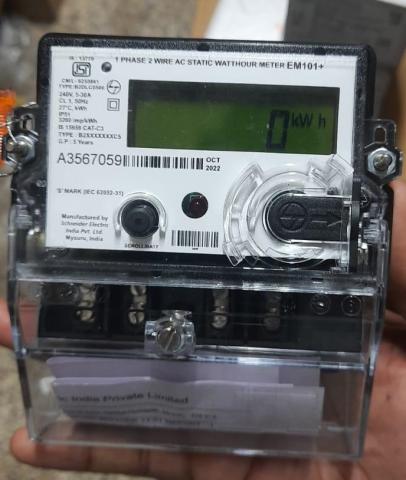

ok, got it. I contacted L & T Technical team here in Kerala-India. They said meter EM101+ Supports DLMS and standard is IS-15959.
On the meter its printed IS-15959 cat C3
So I believe this meter(see img below) will work.
3 years 9 months ago
You can read the meter if it supports IS-15959. You can see the default settings if you select Indian standard as the meter manufacturer in GXDLMSDirector.
