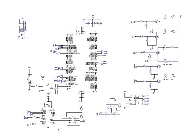

Is this a Hat or have you done this with Maxim 485 chip? If you have done it, can you share the board schematic?
Gerdus
4 years 3 months ago
Here is the circuit with 120 termination on/off Control.
Gerdus

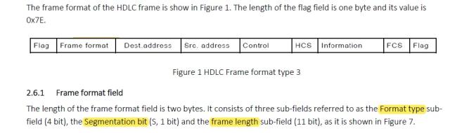

My send data to the meter does not look the same as the working data from GXDLMSdirector. See the frame format.
Here is the string from the Arduino: Not working
7E A0 14 03 41 93 36 82 81 80 08 05 02 03 F2 06 02 03 F2 03 F0 7E FF
Here is the string from working GXDLMSdirector :
7E A0 20 21 25 93 9E 08 81 80 14 05 02 03 F2
06 02 03 F2 07 04 00 00 00 01 08 04 00 00 00 01
0A 75 7E
Here is how the client ini string looks like:
Client.init(true, 32, 1, DLMS_AUTHENTICATION_LOW, "12345", DLMS_INTERFACE_TYPE_HDLC);
Regards Gerdus
Try with this:
Client.init(true, 0x12, 0x10, DLMS_AUTHENTICATION_LOW, "12345", DLMS_INTERFACE_TYPE_HDLC);
Your client and server address are different and for that reason, the meter doesn't reply. If you are using a daisy chain, each meter has a unique server address and you can't use server address 1.
Check Device address from here:
https://www.gurux.fi/Gurux.DLMS.Objects.GXDLMSIecHdlcSetup
Gerdus
I have change the client.ini as suggested by you, Here is the string I get Now:
7E A0 14 21 25 93 80 36 81 80 08 05 02 03 F2 06 02 03 F2 03 F0 7E
GXDLMS Director
0A 75 7E
The first difference I see is 3 byte Arduino 14 and GX 20 and then it is the 7 byte 80 DX is 9E.
So it seems to me it is the frame format wich is different A0 14 GX A0 20
Regards Gerdus
