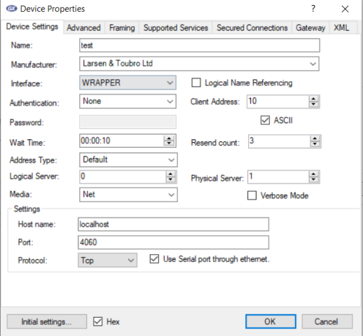

I ran you java server example and run GXDLMSDirector
these are cmd line params on director : -h localhost -p 4060 -r sn -iWRAPPER -t Verbose
pls check attached file
server console is printing client connected
but on director getting error failed to receive data
what could be error ? or can you provide sample data which is working
4 years 7 months ago
You try to connect with WRAPPER and your meter is operating using HDLC.
If you want to use WRAPPER you need to change TCP/IP port from 4060 to 4062.

i tried changing port to 4062 with wrapper
and also HDLC-4060
still same issue.Is there any other setting required
Create a new device. L&G is using Logical Name referencing. Check that it's checked.
Then Select Interface HDLC and port number: 4061. Then accept the changes and connect.

Thanks .I am able to connect.
