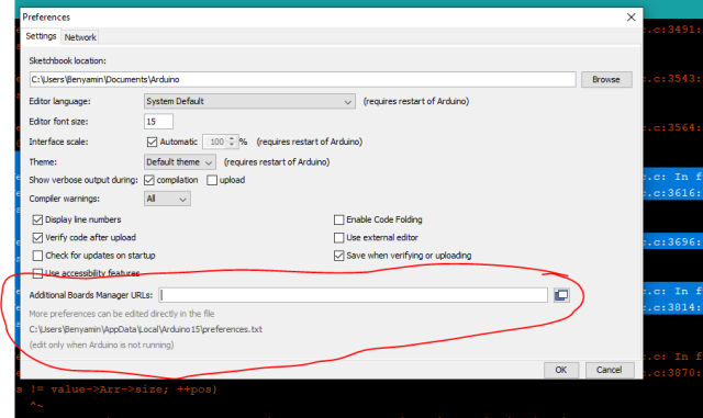

Select Help and About. What is your Arduino IDE version?
Do you have a link for your Arduino board?

Arduino IDE version 1.8.15
No, I did not use the link

There were problems with one Arduino version and I can't remember the version right now. Can you get version 1.8.19 and try with that?
When I was told that I can repeat this error the reason was that the block cipher key was for a different meter. So everything works with Arduino Mega that we have.

hen I try stm32 idecube to find this problem?
benyamin.chesh…
4 years 4 months ago
In reply to 7E A0 0A 00 02 54 FB 03 93 AC by benyamin.chesh…
I solved the problem with a
I solved the problem with a little change in the main libraries
thanks sir
