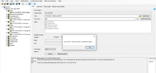

Hii,
With updated version , not able to write date time in the meter.

Can you describe this a little bit more? Are you receiving an error from the meter or is it disabled? Did you try to write date-time using the clock object?

Hii, Snap is attached. BR, AP
Hii,
Snap is attached.

I did try to connect with one meter using GMAC authentication and update the clock. It worked without problems. Can you try to read the association view again? Select "File" and "Refresh". It seems like the clock object is not accessible in this association.
