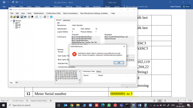

MR ASSOCIATION NOT ESTABLISHING
By SKPALIWAL , 5 August, 2021
13:13:43 Collecting objects
TX: 7E A0 2C 03 41 32 9F 9F E6 E6 00 D0 1E 30 00 00 00 01 C3 4A F9 D0 BC 47 86 8B 1F 2E 7E 43 51 F3 F8 A9 FB 12 50 67 E3 47 00 03 9A A9 C2 7E
13:13:44
RX: 7E A2 05 41 03 52 39 5A E6 E7 00 D4 82 01 F5 20 00 00 00 01 71 88 16 8E CC BC B7 5D 16 9E D3 84 0E 92 40 97 64 41 3D 96 61 73 F3 15 40 6F 32 4B CA C8 41 85 DC E4 52 96 86 F8 8B 94 B4 CB 1F EF BE 7C 86 46 90 6C 7E 2C 1C 49 46 BF 80 52 1D 5E B4 11 66 B4 EF 7E 0C 02 EF C8 4F 6A 3C 3E 1F 91 B1 46 09 29 57 F9 A9 E9 EA DF EA 6E 49 B5 A6 F3 10 CF 73 9A D3 3D FD 95 AF 00 F9 FD 87 E8 EF 5F D9 D3 3E 78 A1 08 33 99 33 D8 12 A6 99 14 95 EC 61 93 87 5C E0 FB F3 AF 8D 5F DD 5D 63 54 94 7C D5 FE 73 D1 F5 4A 72 23 F1 C2 2F 11 3F 2D D5 81 E1 43 17 1E 10 EB 54 72 5E CB 8E F9 FF 3F 09 14 06 23 0F 7F F0 70 E5 EC BA D0 FF C6 3A F4 ED 47 3C C5 9D BA 2B 36 14 9F 13 BA 3F 37 0F 33 20 FC A6 93 D8 6D C7 63 3B 92 41 3D 30 E2 AD 99 0F D7 DE 86 69 20 98 83 8A 01 EC 75 95 06 FC FA EA 1A 9C AE 8E F6 67 B8 E0 B3 AE 68 D5 B7 1B AC E4 F4 DA 49 DC EA D5 52 C6 5D 8E 30 0E 0D A2 88 50 2E D0 51 38 AB CE 8F 63 43 64 3E 53 10 97 5C A1 55 4D 3B 62 99 18 84 4E 27 F5 13 7A 72 A9 7C 20 7A EF F1 EA C1 3F 0E A9 EF B7 DA DC F7 38 39 0A F4 7A 76 47 E6 0C 3F C9 E4 43 43 2D 83 BB 4F A6 DC CF FC 4F 5C 6B 18 8E 21 72 49 55 D2 8E 1D 8E C9 32 31 AE BE 04 8D AE C3 76 51 B2 26 35 53 22 F9 C8 BD 98 77 20 B8 88 F2 03 27 43 86 C4 22 22 41 7C 2F A7 F8 8B 79 38 82 80 2B 9B 66 58 A4 67 58 A9 FE 97 30 46 E9 B5 CE 09 C6 78 F9 9D 0E 5A 9D D5 BB D0 B2 0B EF B2 22 B2 0C C8 F2 8C 40 97 64 C8 05 EF 2B C8 02 6F A4 EE 7F 69 98 EF 04 F1 0C EB D3 85 4E 07 B3 58 78 FF 23 13 E7 D4 C3 40 68 70 C1 F4 69 28 E5 6E 2E 36 19 72 67 A8 CF 4D C4 04 80 B6 7A 49 E0 F6 D0 EF F4 4B BF 03 AD 9F 3C 9C C2 C3 FE 34 D6 7E
5 years 1 month ago
You send the encrypted message using authentication encryption and meter replies using just encryption.
This is a security check that was added a few times ago because this behavior is supported starting Security Suite 1. In Security Suite 0, both parties must use the same ciphering.
Can you connect if you change the Security level from authenticationEncryption to Encryption?
