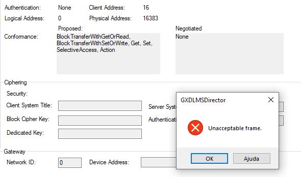

When I try to connect, it returns an "Unacceptable frame" error, as seen on the image below:

This looks good. :-)
Can you add the hex byte log here so I can check what meter is returning?

The good news is that I managed to establish communication, with the WRAPPER interface, instead of HDLC, but there are only 2 options (print below), how can I add more OBIS codes to read the measurements?
5 years 2 months ago
Meter is not accepting AARQ message. It's a strange because it accepts SNRM message.
You need to change the authentication level. There is four authentications in your meter.
If you read example #2 you can see what client and server address you need to use (ClientSAP and serverSAP) and what authentication level you need to use (Machanism ID in Authentication Machanism Name tab).
