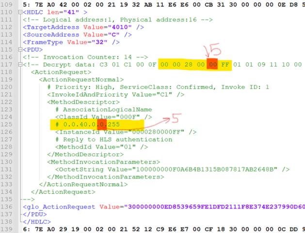

I tried the below log and chared with the manufacturer and told me the issue in some commands requests security 0 not 5

<- ١٥:١٧:٤٦.٧٢٣ 7E A0 0A 00 02 00 21 19 93 C2 BC 7E
-> ١٥:١٧:٤٦.٨٣٢ 7E A0 23 19 00 02 00 21 73 CE 10 81 80 14 05 02 05 DC 06 02 05 DC 07 04 00 00 00 01 08 04 00 00 00 01 A9 0D 7E
<- ١٥:١٧:٤٦.٨٨٥ 7E A0 6E 00 02 00 21 19 10 A2 C1 E6 E6 00 60 5D A1 09 06 07 60 85 74 05 08 01 03 A6 0A 04 08 41 45 43 01 01 CE A7 7C 8A 02 07 80 8B 07 60 85 74 05 08 02 05 AC 12 80 10 26 07 65 3F 4A 67 18 4F 5F 2D 19 00 75 1C 2F 19 BE 23 04 21 21 1F 30 00 00 00 0D 68 A9 12 AB F8 D7 D7 9B 1B 8B B6 17 6F BA 89 86 37 9E 0D 69 18 93 12 44 71 5F 36 7D 7E
-> ١٥:١٧:٤٧.٢٥٥ 7E A0 72 19 00 02 00 21 30 4B 8D E6 E7 00 61 61 A1 09 06 07 60 85 74 05 08 01 03 A2 03 02 01 00 A3 05 A1 03 02 01 0E A4 0A 04 08 41 45 43 01 01 CE A7 7C 88 02 07 80 89 07 60 85 74 05 08 02 05 AA 0A 80 08 6B 54 44 43 75 70 56 49 BE 23 04 21 28 1F 30 00 00 00 0B CA 98 26 32 D5 B0 2D 13 BF AA F7 C0 7A 77 D8 8C 90 AB 98 01 71 57 B6 69 44 5D BC 0C 7E
<- ١٥:١٧:٥٧.١٥٨ 7E A0 42 00 02 00 21 19 32 AB 11 E6 E6 00 CB 31 30 00 00 00 0E D8 53 96 59 FE 1D FD 21 11 F8 E3 74 E2 37 99 0D 60 FB DD 0E 93 7E CF EA A7 4D 4A 8A 98 7F 27 B8 6A 5C 36 79 6D 1A A7 85 8C B8 6C A1 F1 86 7E
-> ١٥:١٧:٥٧.٥٧٧ 7E A0 29 19 00 02 00 21 52 12 C9 E6 E7 00 CF 18 30 00 00 00 0C DD 96 49 0B 37 19 3A DD 4A 77 11 C5 A3 9C 30 90 A2 A7 37 F8 F9 7E

I already read the invocation counter and increased it and there are other meters from different brands working correctly. but this meter not working and the manufacturer sends me the above comment and I'm not sure he catches the issue.
