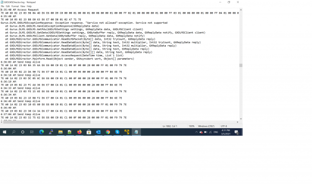

Now, I have some questions about exceptions. I have tried to read some objects, but even if meter is connected I get exception. Can you check log file and let me know if this is already knows problem?
I was not able to attach logs due to upload limitations. If you need I can send it over to you directly?
Thanks.
Tijana
5 years 6 months ago
Please, don't add pics. Reading bytes from plain text is easier.

Here is the text from logs:
06:34:56 Initializing serial connection.
6:34:58 AM Send SNRM request.
7E A0 08 02 23 03 93 3E 74 7E
6:34:58 AM
7E A0 21 03 02 23 73 AA C4 81 80 14 05 02 00 80 06 02 00 80 07 04 00 00 00 01 08 04 00 00 00 01 CE 6A 7E
06:34:58 Parsing UA reply succeeded.
6:34:58 AM Send AARQ request.
7E A0 45 02 23 03 10 FB 7F E6 E6 00 60 36 A1 09 06 07 60 85 74 05 08 01 01 8A 02 07 80 8B 07 60 85 74 05 08 02 01 AC 0A 80 08 31 32 33 34 35 36 37 38 BE 10 04 0E 01 00 00 00 06 5F 1F 04 00 00 1E 5D FF FF A9 FD 7E
6:34:58 AM
7E A0 38 03 02 23 30 11 51 E6 E7 00 61 29 A1 09 06 07 60 85 74 05 08 01 01 A2 03 02 01 00 A3 05 A1 03 02 01 00 BE 10 04 0E 08 00 06 5F 1F 04 00 00 1A 1D 04 C8 00 07 14 7A 7E
06:34:58 Parsing AARE reply succeeded.
6:35:13 AM Send Keep Alive
7E A0 1A 02 23 03 32 75 62 E6 E6 00 C0 01 C1 00 0F 00 00 28 00 00 FF 01 00 F9 79 7E
6:35:13 AM
7E A0 19 03 02 23 52 D0 7A E6 E7 00 C4 01 C1 00 09 06 00 00 28 00 00 FF B6 6E 7E
6:35:28 AM Send Keep Alive
7E A0 1A 02 23 03 54 45 64 E6 E6 00 C0 01 C1 00 0F 00 00 28 00 00 FF 01 00 F9 79 7E
6:35:28 AM
7E A0 19 03 02 23 74 E4 3E E6 E7 00 C4 01 C1 00 09 06 00 00 28 00 00 FF B6 6E 7E
6:35:43 AM Send Keep Alive
7E A0 1A 02 23 03 76 55 66 E6 E6 00 C0 01 C1 00 0F 00 00 28 00 00 FF 01 00 F9 79 7E
6:35:43 AM
7E A0 19 03 02 23 96 F8 FA E6 E7 00 C4 01 C1 00 09 06 00 00 28 00 00 FF B6 6E 7E
6:35:48 AM Access Request
7E A0 6D 02 23 03 98 0A 4D E6 E6 00 D9 C0 00 00 01 00 08 01 00 08 00 00 01 00 00 FF 02 01 00 08 00 00 01 00 00 FF 03 01 00 08 00 00 01 00 00 FF 04 01 00 08 00 00 01 00 00 FF 05 01 00 08 00 00 01 00 00 FF 06 01 00 08 00 00 01 00 00 FF 07 01 00 08 00 00 01 00 00 FF 08 01 00 08 00 00 01 00 00 FF 09 08 00 00 00 00 00 00 00 00 75 FB 7E
6:35:48 AM
7E A0 10 03 02 23 B8 E0 63 E6 E7 00 D8 01 02 A7 71 7E
Gurux.DLMS.GXDLMSExceptionResponse: Exception response. "Service not allowed"-exception. Service not supported
at Gurux.DLMS.GXDLMS.HandleExceptionResponse(GXReplyData data)
at Gurux.DLMS.GXDLMS.GetPdu(GXDLMSSettings settings, GXReplyData data, GXDLMSClient client)
at Gurux.DLMS.GXDLMS.GetData(GXDLMSSettings settings, GXByteBuffer reply, GXReplyData data, GXReplyData notify, GXDLMSClient client)
at Gurux.DLMS.GXDLMSClient.GetData(GXByteBuffer reply, GXReplyData data, GXReplyData notify)
at GXDLMSDirector.GXDLMSCommunicator.ReadDLMSPacket(Byte[] data, Int32 tryCount, GXReplyData reply)
at GXDLMSDirector.GXDLMSCommunicator.ReadDataBlock(Byte[] data, String text, Int32 multiplier, Int32 tryCount, GXReplyData reply)
at GXDLMSDirector.GXDLMSCommunicator.ReadDataBlock(Byte[] data, String text, Int32 multiplier, GXReplyData reply)
at GXDLMSDirector.GXDLMSCommunicator.ReadDataBlock(Byte[] data, String text, GXReplyData reply)
at GXDLMSDirector.GXDLMSCommunicator.ReadDataBlock(Byte[][] data, String text, GXReplyData reply)
at GXDLMSDirector.GXDLMSCommunicator.AccessRequest(DateTime time, List`1 list)
at GXDLMSDirector.MainForm.Read(Object sender, GXAsyncWork work, Object[] parameters)
Kind regards,
Tijana
You try to use the Access service and the meter doesn't support it. You can't use the Access service and you need to read all items using the normal read.
