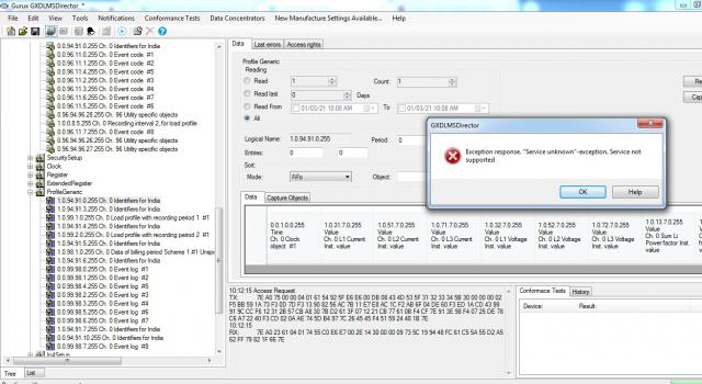

I am reading IS 15959-2 METER using GuruxDLMS Director latest ver 8.2.2102.2602. while reading Individual object from Data,register,extd. register,Association and profile objects class getting an error "Service Not supported". this was previously working with older version of Gurux director.
But when reading all the objects from IC Node its reading all the object under the class.
following is the log trace i am sending while reading an Individual data class object.could you please help me regarding the issue.
Reading Individual data object. error Came as "Service not supported"
10:17:45 Access Request
TX: 7E A0 75 00 00 04 01 61 54 92 5F E6 E6 00 DB 08 43 4D 53 5F 31 32 33 34 5B 30 00 00 00 02 F5 BB 59 1A 72 F3 0D 7D F3 13 90 82 56 AC 7B 11 E7 E8 AC 1C F2 AB 6F 04 DE 60 F3 ED 1A CD 43 99 91 9C CC F6 12 31 2B 57 CB A8 30 7B D2 61 3F 07 12 21 CB 77 61 0B F4 CF 7E 91 3E 98 F4 07 25 DE 78 C6 A7 22 40 F3 CD 02 0A AE 98 C2 A8 2E 1A E9 20 15 4E ED B7 89 3B 55 7E

RX: 7E A0 23 61 04 01 74 55 C0 E6 E7 00 2E 14 30 00 00 09 77 4E 3F 4C E1 EA F5 31 4E 4F 78 68 EE A1 AD 7A A2 BB 7E
5 years 6 months ago
You try to use Access-service and the meter is not supporting it. Meter is returning invalid negotiated conformance where access-service is added. Un-check Access-service from the "Supported Services" tab.

Hi mikko,
Hi mikko,
thanks for the support.It is now working as expected
You should ask the meter manufacturer to remove the Access-service flag from the meter so it does not break the conformance.
