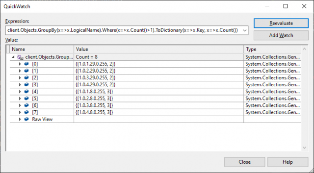

Hello, when i get association view there are some duplicates in ObjectCollection.
code:
ReadDataBlock(client.GetObjectsRequest(), reply);
client.ParseObjects(reply.Data, false);
In my case i have 8 duplicates and there are not the same instance, but new ones. What could be the reason of that? Is it safe if I remove duplicates?
5 years 6 months ago
There is an issue on the meter and objects are added several times to the association view. You need to ask the meter manufacturer to fix this. You can remove duplicates.
