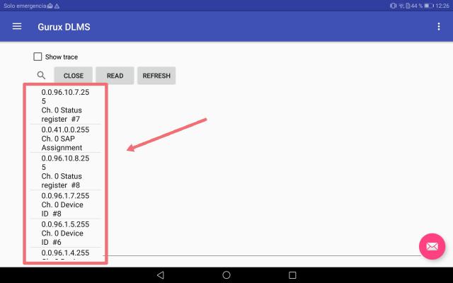

Hello!
Hello!
I'm trying to config the GXDLMSDirector with the IP and port that you said: Port: 4061 and for the IP I'd used localhost and the IP that I get when I look at the "ipconfig" of my pc. And It not works.
Anyway, the thing that I wanna do is to use a OBIS code concrete to my meter to receive the information that I want or to make that the meter do something that I want. I saw that some OBIS codes are executing (I attacth a capture of my tablet with the GuruX app running). If I want to receive the "Active energy import (+A)", for example, and I wanna have that information on that side of the ListView, I need to use the OBIS code 1-0:1.8.x.255. What I have to do to use that code?
I don't know if I am understanding the use of OBIS codes or how the app is using it. Or even if it is possible to do it.
Thanks to ask me.

5 years 2 months ago
Hello Sergio,
Hello Sergio,
I'm sorry, but I haven't noticed your question before.
OBIS code (Logical name) is used to identify the object. It can be a register, clock, etc. Idea is that all meter manufactures are using the same OBIS codes.
