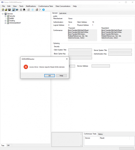

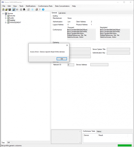

We are focusing now on giving each object its attribute and method access level depending on the type of association. For example, the public client has a very limited access to object to read. Based on the enumeration "DLMS_ACCESS_MODE", we used these 4 types of access level : DLMS_ACCESS_MODE_NONE, DLMS_ACCESS_MODE_READ, DLMS_ACCESS_MODE_WRITE and DLMS_ACCESS_MODE_READ_WRITE.
Logically the DLMS_ACCESS_MODE_NONE is used when we do not want to give any access for an object for a specific type of association. We tried this access level for different object and it worked. It was giving "NoAccess" in the GXDLMSDirector. However we faced two problems with two different type:
1- DLMS_OBJECT_TYPE_PROFILE_GENERIC: while using the getProfileGenericAttributeAccess() function we tried to return "DLMS_ACCESS_MODE_NONE" when the authentication is none. When trying to read the list of object, when it reaches the profile generic object it is giving the following warning "Access Error: device reports read-write denied". However the list of object was read successfully and the corresponding profile generic are showing "NoAccess" which is correct. Our problem is with this warning that shouldn't supposed to appear and it is causing trouble while reading. (check picture)
lara.wakim
5 years 6 months ago
2- DLMS_OBJECT_TYPE_IEC_HDLC
2- DLMS_OBJECT_TYPE_IEC_HDLC_SETUP: while using the getHdlcSetupAttributeAccess() function we tried to return "DLMS_ACCESS_MODE_NONE" when the authentication is none. When trying to read the list of object, when it reaches then end and try to read the iec hdlc setup object it is throwing the following error "Access Error: device reports read-write denied"(check picture). However after that error the list of object wasn't read successfully and no objects are shown. It is urgent to track that error and solve it because it is blocking completely the reading. If you also have any idea what it is happening please share.
N.B: to easily repeat these problems just return "DLMS_ACCESS_MODE_NONE" for the type DLMS_OBJECT_TYPE_IEC_HDLC_SETUP and DLMS_OBJECT_TYPE_PROFILE_GENERIC and you will obtain the error and the warning respectively.

Capture objects are read and it doesn't care from access right because they are always set.
Check is added for capture objects read and capture objects are not read if read is not allowed.
In reply to 2- DLMS_OBJECT_TYPE_IEC_HDLC by lara.wakim
Don't add the non-accessible objects to the association view. If a user can't access the object, don't show it. Check NONE_OBJECTS from the main.c. It will show only a few objects when use connects without authentication.
This is the correct way to handle objects that the user can't access.

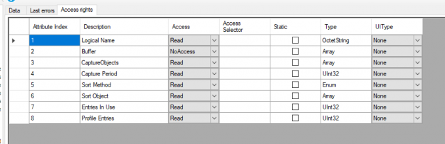

We are facing a weird problem with the profile generic and we were not able to track it. We will explain it to you maybe you can guide us to find what are we doing wrong or what are we missing.
When we try to capture some row successively of a profile generic we reach a stage where we were not able to read the rows of the buffer in the GXDLMSDirector because the access level of the buffer (attribute 2) has switched alone from "Read" to "NoAccess" (check the picture). We were not able to know what is the reason behind this random change.
If you have any idea or explanation please share it with us.
Best Regards,
Lara Wakim
Meter returns an error and because that access level is changed to no access. There are some meters that don't use association view correctly and some attributes are not implemented. For this reason, the returned error changes the access level. Change it back from "no access" to "Read" and you can continue as normal.
